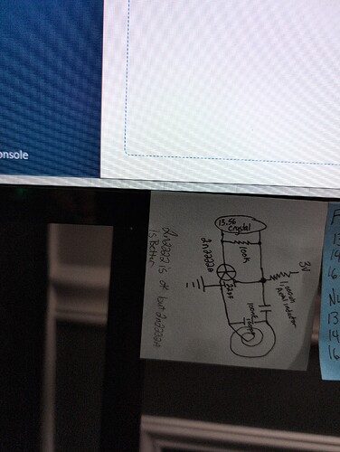

I’m currently creating a HF Field generator using what is being called a Stiffler Exciter circuit.
I’ll be updating this thread with my progress.
Arent there typically a pair of capacitors on the crystal to allow it to oscillate?
I admitantly did little research on how the crystal oscillator works. I ran a few different circuits to find which worked best with a printed circuit board and this configuration gives me the best range with a 3v input. Although I’m open to other configurations this uses the least amount of components. Ideally I would like to make something that is simple for a beginner solderer to easily build and play with.
Im no EE i just thought it was odd to see a crystal without the standatd pair of caps. But if it works it works right.

The post it note picture I posted above is actually the actual circuit I use in my diy field generators that is perfect for powering a xsiid
I actually keep it on my computer and reference it with some of the different circuits I’ve been playing with. As soon as I have time I’m going to drop this in GitHub as open source.
