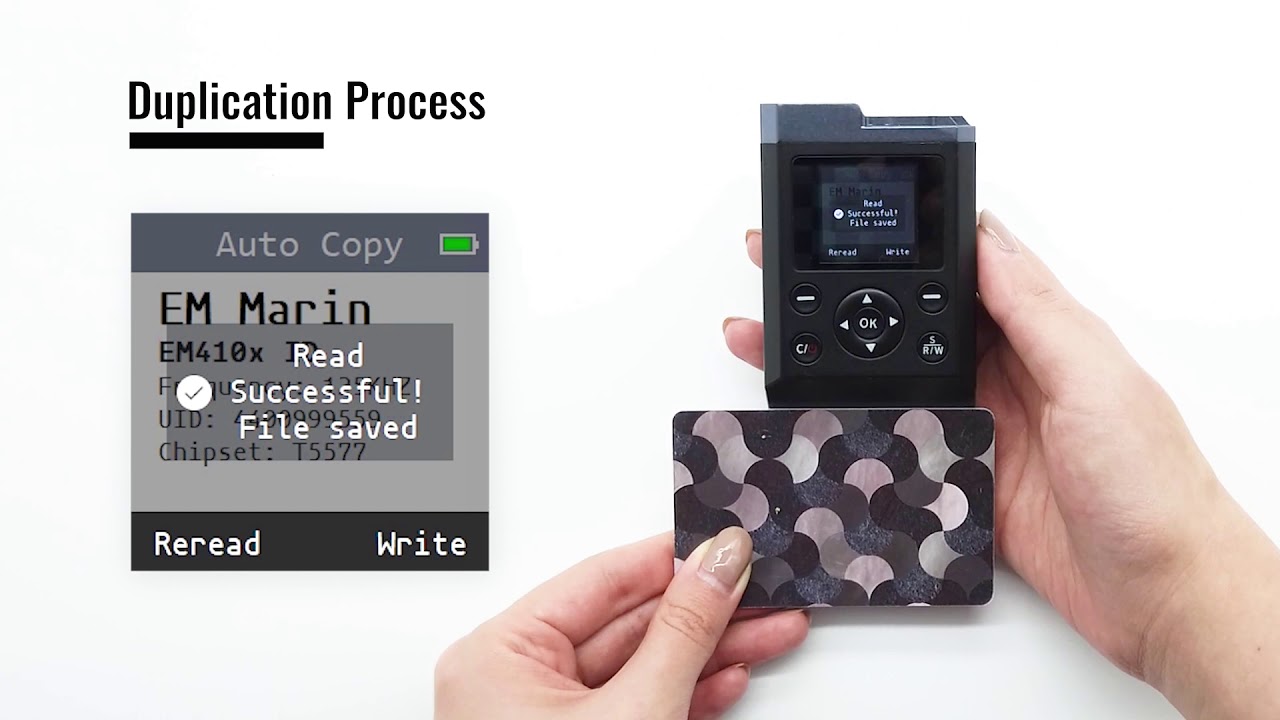

iCopy-X **looks like a proprietary piece of SHIT :Poop:**
icopy-x
looks promising
RFID Card Copier
“Replacement” for a ProxMark?
More suitable for us than a Flipper Zero?
Will it read and write to an xSeries :man_shrugging:
$199-$465
