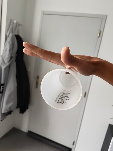

I can try it at home with a Lodestone68 in -P0 (thumb webing on palm side) but my guess is that the other object is gonna have to be a magnet for this to work reliably.
I’ll post photos
It works great with a magnet. Surprisingly well. You can catch it and release it easily. Great fidget toy
