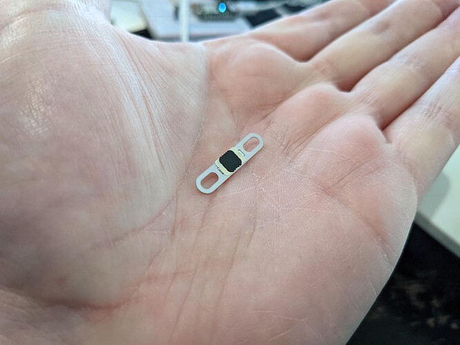

VivoKey Apex update
The initial units look good!
Next steps;
  • inspection and testing of the remaining units
  • programming of each unit with keys and applets
  • encapsulation testing
  • full production
Probably a couple weeks until then because right now I’m flat out doing a Walletmor batch production.

those wings look perfect for adding nfc nails to… i’ll take mine in purple and green. kthxbai
If you want them to fail in six months and reduce the performance of the apex, go ahead
Or wait ~ 6 months :man_shrugging:
How much would it reduce the performance of the apex?
The three on my rigidified flex next are doing absolutely fine after more than 6 months of torture :open_mouth: I still can’t believe it but there must be a fine line of maximum flexing and this implant is right above it. If those wings are rigid then maybe?
Good idea in theory, but the problem is, those antennas have not been designed or tuned to have parasitic LEDs that will subsequently affect the magnetic field and therefore the range / coupling / performance of the actual Apex.

Looks good. Will that be the Form factors? How big it is?
7.5 x 28 x 0.5mm ish, that’s the size roughly. Similar / the same as the walletmor or flexdf2
I’m exploring this mutual resonance for the Apex Mega and the CoM chips right now. My current hypothesis is that the Apex will only be slightly detuned (based on read range tests and induced signal amplitude because I can’t measure its individual peak with a VNA), but the more in line with the antenna plane that the LEDs are the more detuned they become. I’m still quantifying it.
