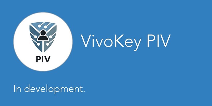

The required feature for bitlocker is in development so it should be possible to use the Apex to unlock portable and fixed data drives.

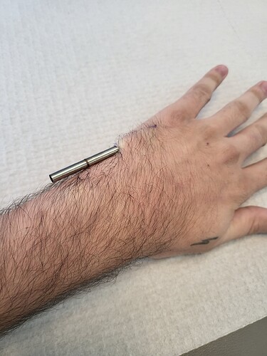

Installed. My new guy (haven’t been to him before) flattened the needle and said it makes them way easier to put in.
How so? It doesn’t look flattened in the photo? Do you have an example photo of the needle alteration?
I’m super interested to know what the goal was exactly. Wasn’t to improve the insertion process? Getting over the bevel? Did the professional use lubrication on the needle?
Actually I would love to have a conversation with them if you can DM me their contact information?
He old flattened the first half of the needle and said it made it slide in easier, he did use lube (his own not the included packet) I wasn’t in the room when he did it, but looked like just pliers clamping it down. He said “It’s like I make it into a scalpel” and I’ll DM you his info now.
It’s often a good idea to shave the area prior to penetration :rofl: , but since you didn’t, just make sure to keep the hair clear of the healing area
Is that L4 position you went for? I’m thinking of that but didn’t know if it’s still too close to the knife edge and should do R3 instead. Let me know how it feels in that location.
It is, I’ve had other implants in the blade with no issues but after hearing it might not be the best I played it safe and cut the difference. It’s right in line with my hair line on the hand. I’ll keep an update on the healing and post healing feel.
