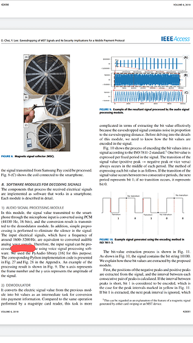

Does the mag-stripe emulation capability not actually allow Samsung to read low-frequency, just make use of it in communicating with payment devices? Sorry if this is a dumb question!
Storing his records on his tag would mostly be for my own use and peace of mind, I definitely don’t expect a vet or shelter to look for anything beyond an ID match in their system, if that - the readers specifically for animal tags seem to have very, very limited utility. Mostly just ID and temperature if the chip is enabled for that and it’s a nicer model.
Definitely not a dumb question, but sadly not. The Magnetic Secure Transmission technology that Samsung utilizes operates between 1600-3200Hz, not 125kHz
This makes sense though, because it has to emulate a person swiping a card. Credit card magstripe tracks only have a few hundred bits, and it takes people about a third of a second to complete a swipe, so that frequency works out.
It might seem like once you have an RF transmitter set up in a phone it would be a simple matter to change to any frequency, but that is not the case.

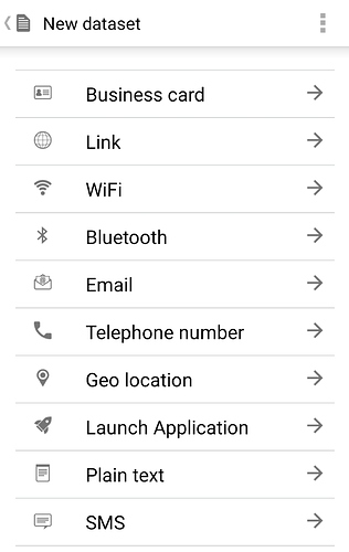

You actually have a bunch of options.
You will be able to read and write with your phone
an NDEF MESSAGE
Plain text info
A link to a web page with all the info
Also your contact information, address, location, vet location etc.
