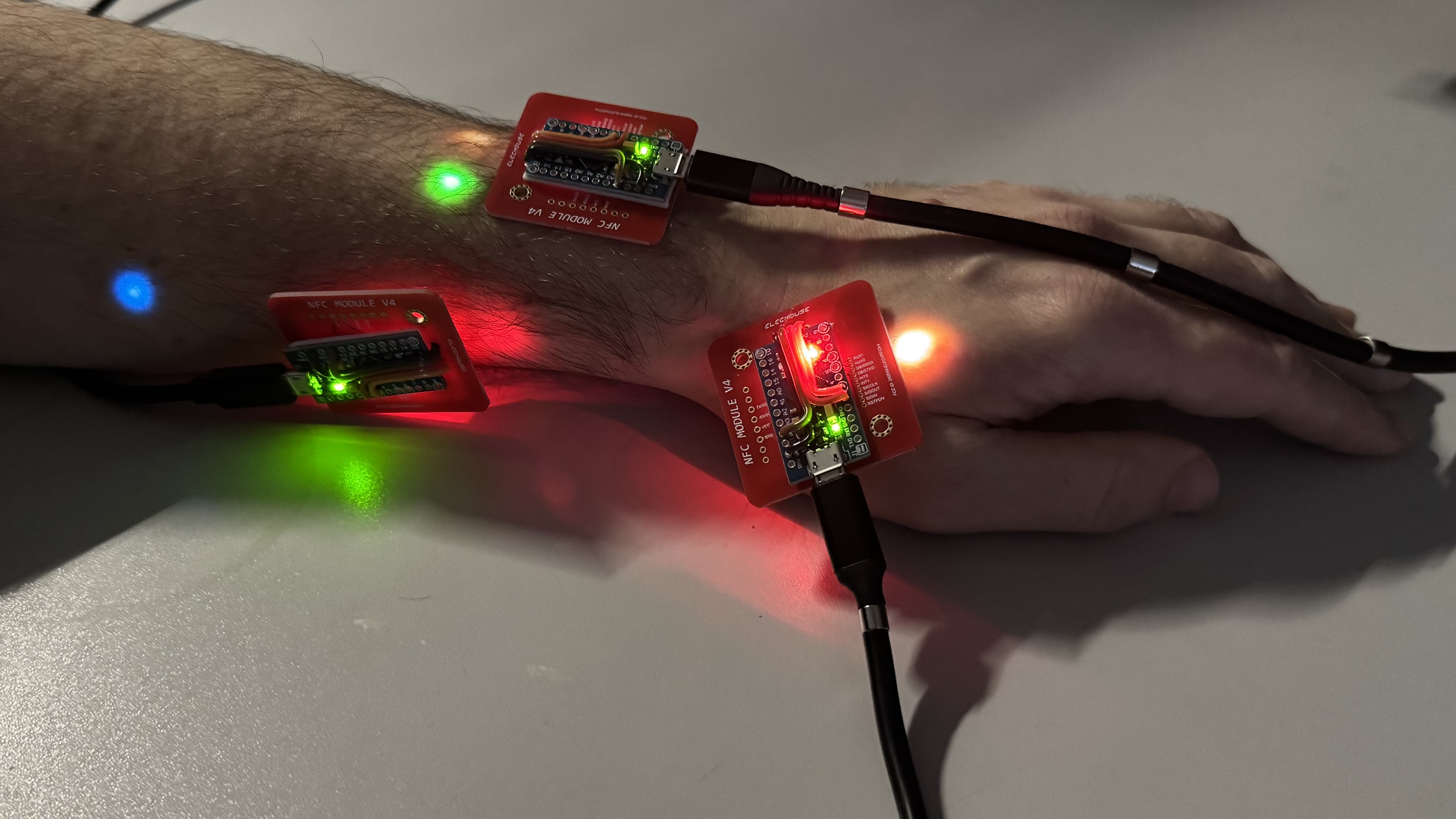

Which color is your xSIID LED?

Got the blue. Yours are looking awesome - very bright!
It took about a month for mine to be fully visible (also blue)
So itās been about three weeks now. I can definitely read the xSIID but no sign of the LED lighting up. Am I missing something or do I need to get another implant? Attempting to light it up with FlipperZero NFC reader.
the LED may take a bit longer than 3 weeks to see in direct light. The normal thing is to wait 3 weeks for successful reads. Sometimes the positioning of the implant make the LED appear dimmer than most depending on color.
give it another week or so and you should be fine.
I know mine (blue xsiid) took around 5 weeks before it could be seen in a dimly lit room. now it can be seen when i scan it or use a field generator at any brightness except direct sunlight.
