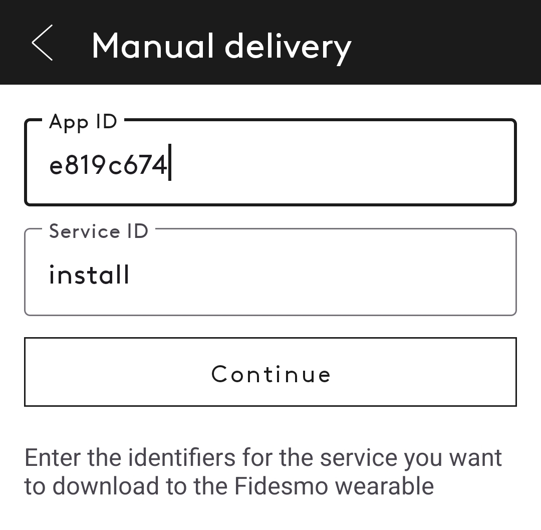

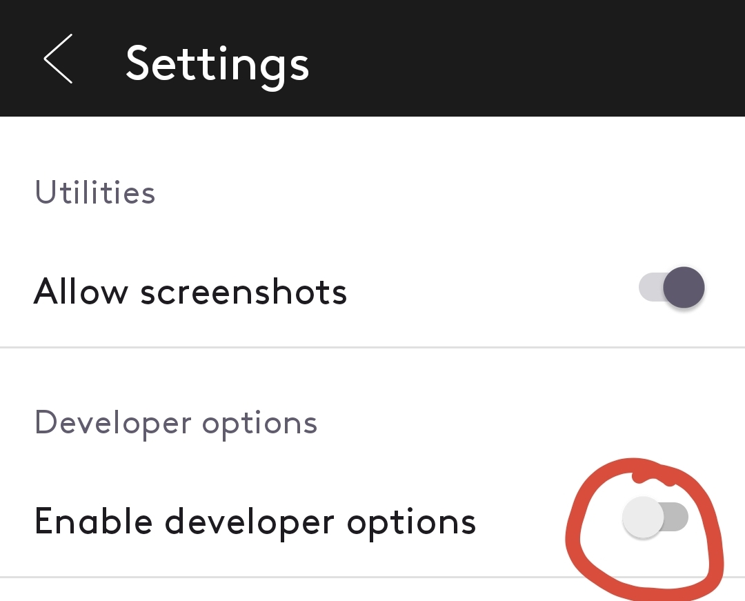

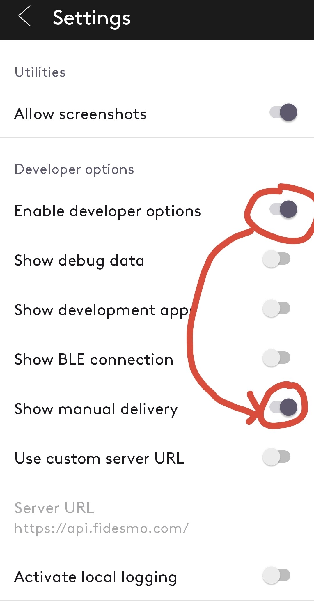

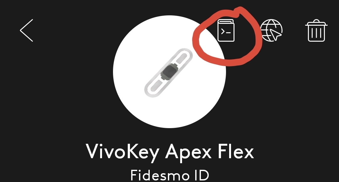

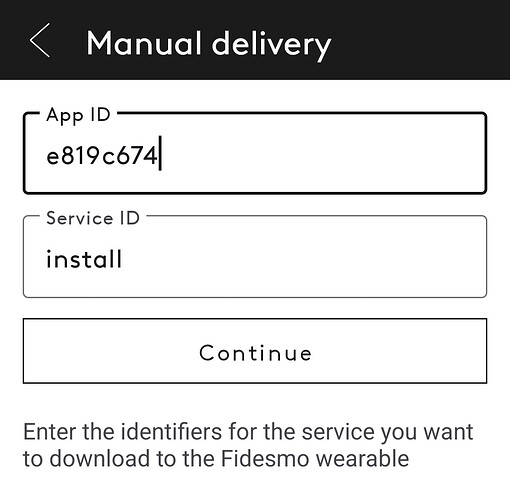

@Pilgrimsmaster ok thanks, good to know. The reason I ask is because I donāt own any Android devices and the iOS app doesnāt have the Tesla applet, or its not complete yet or something⦠so Iām looking for the easiest way to do it in my scenario.
Hopefully you can manually deploy the app.
- VivoKey Tesla Keycard
- e819c674
If iOS is the same as Android
Select your Apex, then this icon
Let us know how you go
That worked perfectly to install the applet on iOS, thank you. Now Iām just having a hard time angling my hand into the scanner in front of the cup holder bc of Cybertruck⦠once the applet is installed to the Apex Iām good to go right? I can just add new keycard and attempt to scan? I may need to try replacing a repeater sticker in the keycard place, my hand is just not small enough to get where it needs to be I think.
