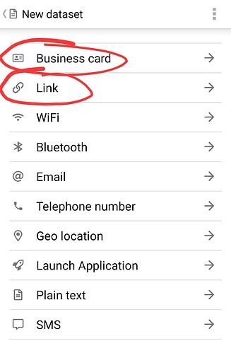

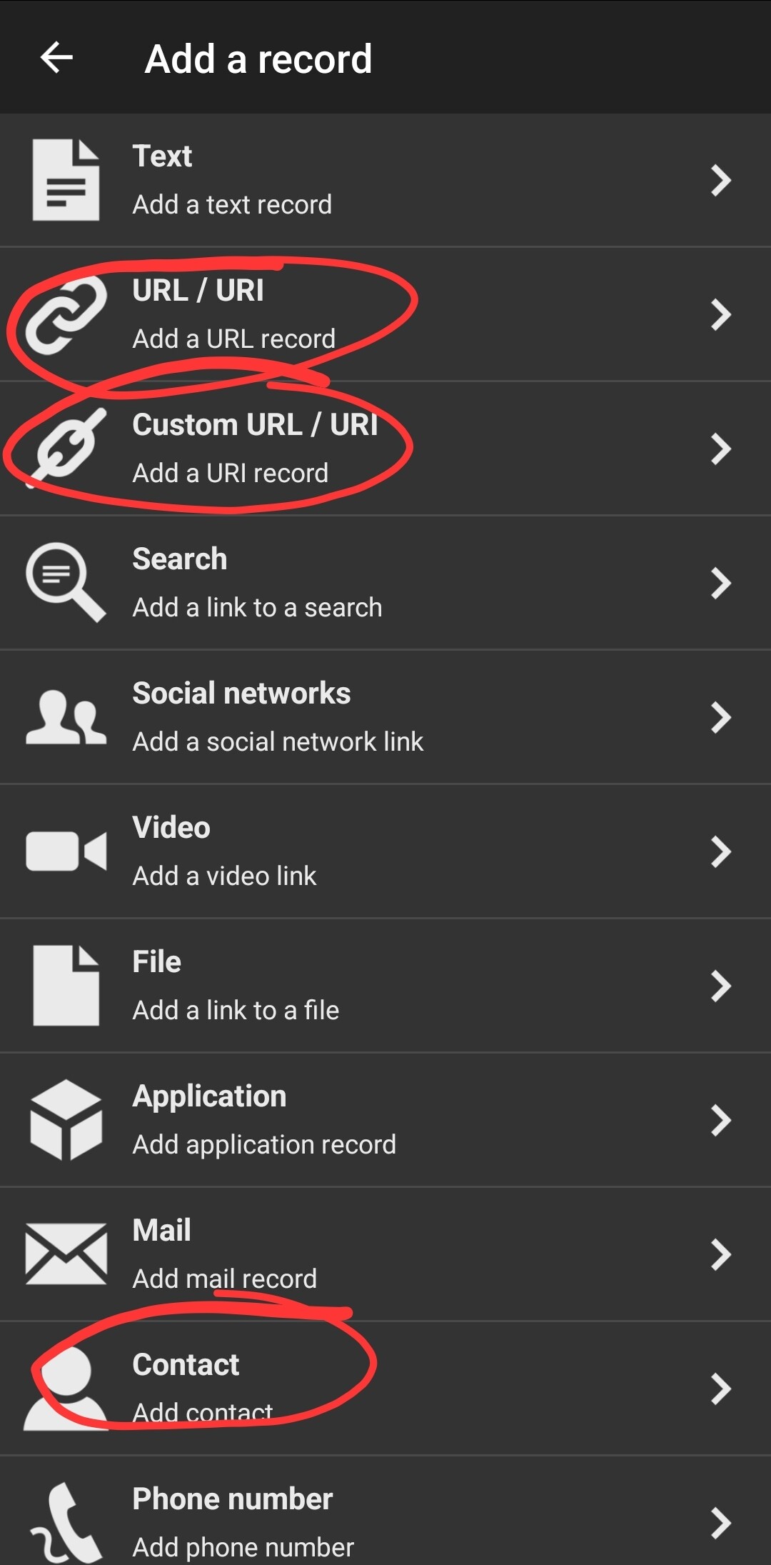

Thats actually easy,
Rather than writing text, you should be writing business cards or links

:logo_nxp_tagwriter:
:nfc_tools:

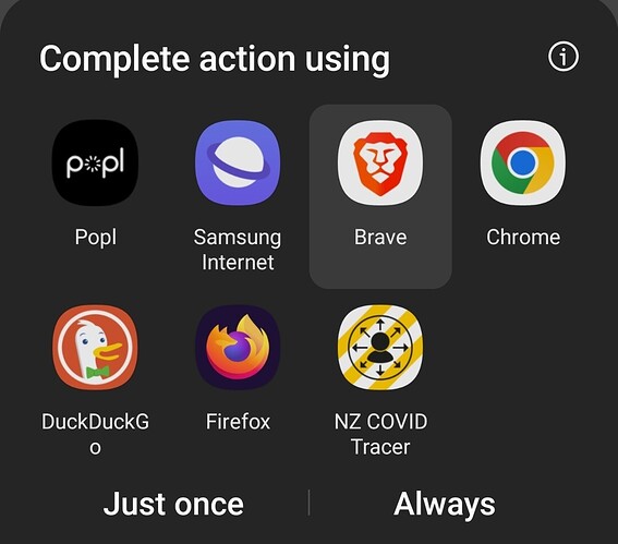

I just set up a Popl link and scanned it
This is a likely the similar result you will get from your Android test
Or if you have a default app setup, it would go direct to the page
