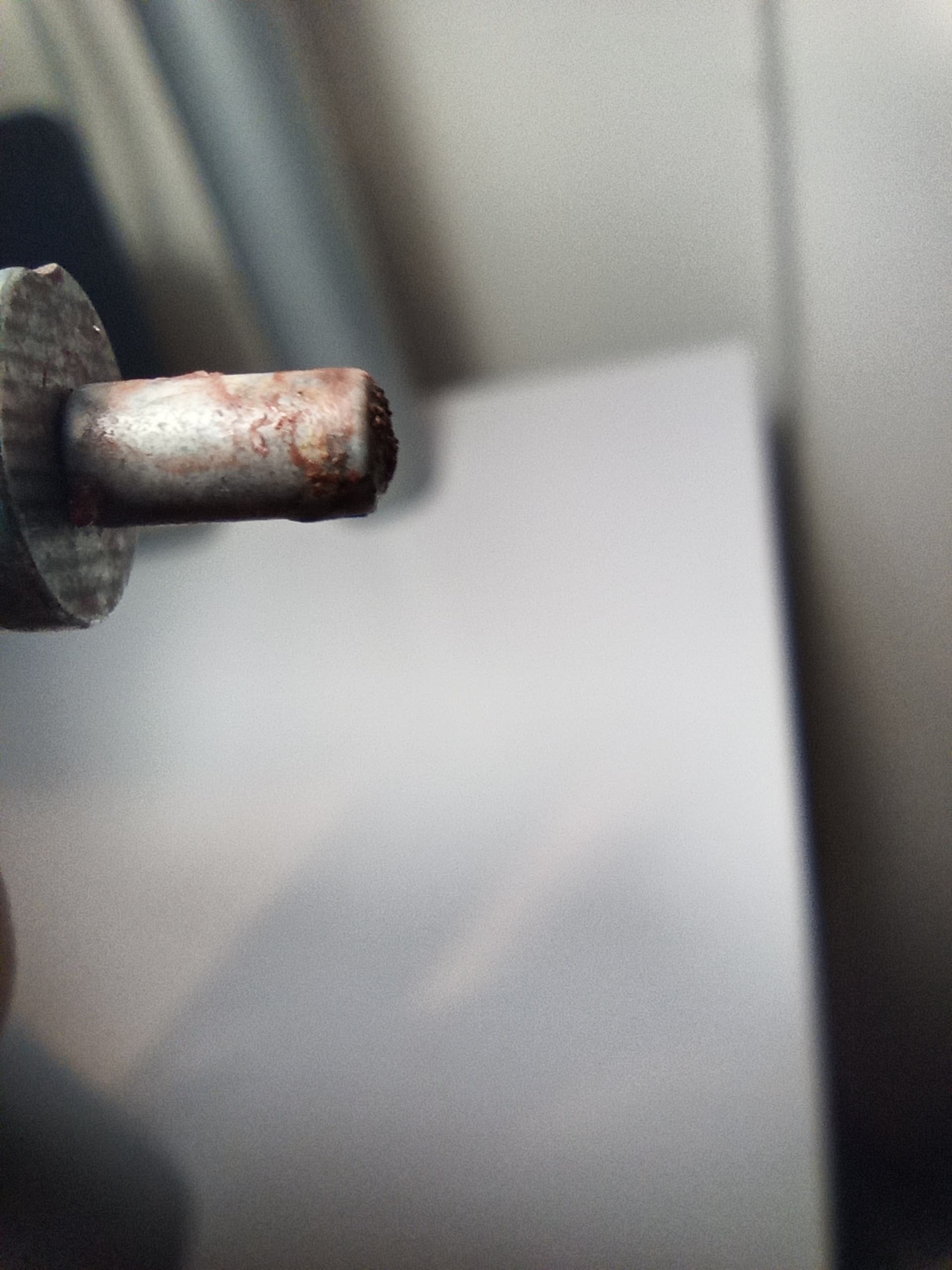

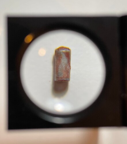

@Pilgrimsmaster @Atilla it was an interesting and complicated removal, the capsule was so solid that my initial incision over the implant site actually migrated it. I had palpated and used a field analyser to find it so I knew I was right over it. In the end I had to use a magnet to isolate it and draw it back into the field and dissect it out.
It’s interesting to see the corrosion erupting from the fracture lines typical of parylene coatings on magnets.

A tingling started after 2 years of the installation. That feeling got more frequent, especially after consuming acidic drinks. The tissue slowly thickened around the magnet. The whole process was slow and smooth through out the time.
There is a feeling of silence now. :relieved:
an almost insidious progression… one might convince themselves to completely ignore it until the thing just burst open.

I’d imagine since it started 2 years after installation that the sensation was caused by chemical breakdown of the magnet and that was causing tissue irritation and probably some amount of necrosis.
