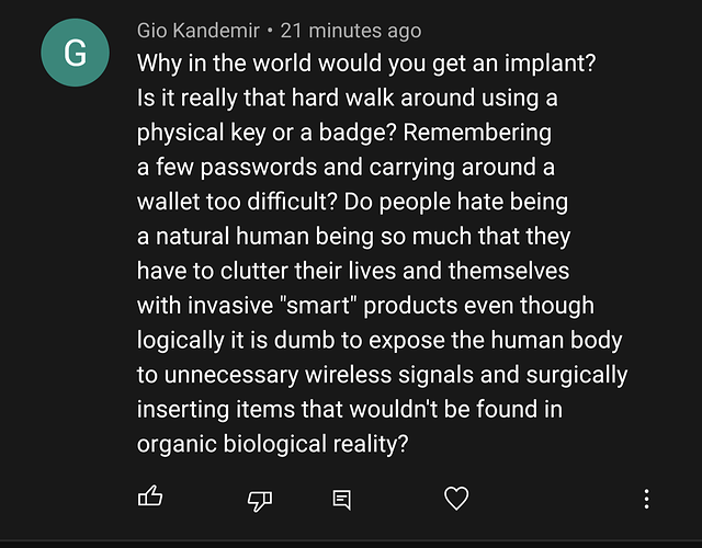

Received this entertaining comment on my Flipper video. Some people really just do not get it.
ā€œOrganic biological realityā€ lmao

Yes I do hate being a natural human being because I share DNA with that person lol
And also all the mental and physical flaws that come with being human. Why wouldn’t you want to progress humanity further by chipping away at flaws like having to carry stuff that you can loose which then cause headaches and time/money loss?
