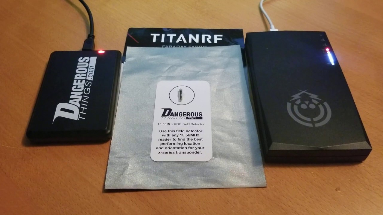

Titan RF fabric vs the NFCKill.
While it does seem to protect against the absolute disabling of the field detector there was a significant brightness change that may not have been captured on video. I’m betting this still has the potential to corrupt information on the more capable implants.

So, since the Titan fabric doesn’t do enough shielding alone I think I’m going to shift to a 3d printed solution. I just bought a Prusa i3 Mk3s but it won’t be in for a few weeks at least, I’m also going to pick up some of that PLA-Graphene filament. I’m looking at 3d scanners too that might help with creating a custom fitting piece.
