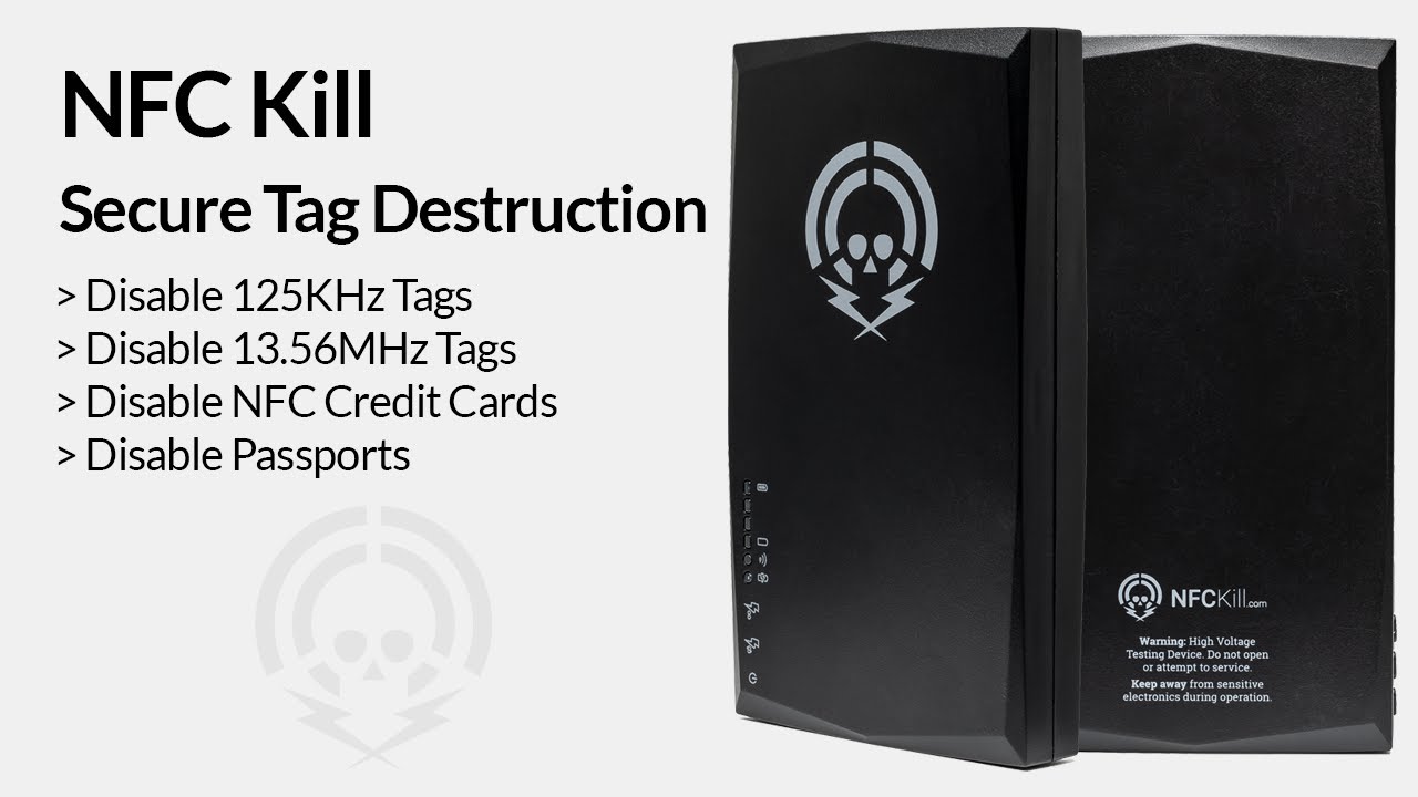

My hunch is that if you presented the NFC Kill device, which is designed to kill NFC tags, to an NFC reader instead… you would be able to fry a large percentage of NFC readers, probably including some smartphones.
They list readers as being effected by it, it even kill’s wireless power chargers AFAIK
