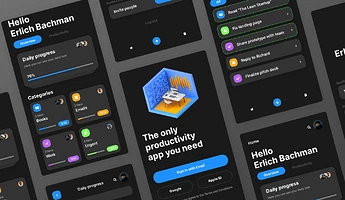

I’m trying to anticipate the UI design for my nfc multitool and would like some opinions. So far I’m aiming for something in between these two aesthetics:
But I’m not super hyped about them and it’s still pretty vague so if there are apps that you like the design of or if you can find a reference image like these that you like please send it my way :grin:
Edit: Imo the first one is a bit simple and outdated, not slick. The second one is too much and a technical challenge given that I’m working with Unity. Overall I’m going for a modernized Github color scheme with a futuristic/tech hint.

Still looking for the right look. I want to use one of these as reference for the nfc app
What do we think?
  • 1
  • 2
  • 3
  • 4
0 voters
Edit: I think something is broken with the polls. The percentages are calculated as option votes/total voters instead of option votes / total votes … :joy:

Based on the poll and my own restrictions started laying out a little something
I didn’t go full neuromorphic UI even though I have the asset for it because it didn’t look right. Instead, I mixed aesthetics from options 2 and 4.
Of course, this is just 4 buttons. It’s still missing the rest of the layout
