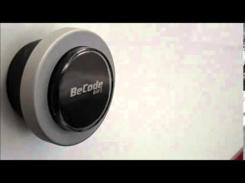

Okay, I got the BeCode lock installed on my locker door at work, and… it works! Not only that, it works surprisingly well too. Check it out:
https://www.dailymotion.com/video/x7swyjw
Here’s a photo of our lockers at work: can you guess which is mine? :slight_smile:
Closeup of the lock:

Once the lock is installed, it just works. It’s that simple. It’s solid (for a locker lock at least - I suspect a good sledgehammer wack would bust it easily enough), it’s well made, it looks smart, and most importantly for us, it works extremely well with implants. Seriously, it reads an NFC implant even more easily than an ACR122. For a battery-powered device, that’s really quite remarkable.
