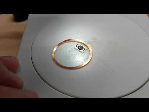

I also recorded this to address construction concerns.

Really it’s about not being able to take the time to type out the 1000+ words that I can say in 100 with a quick video.
Not only that, but showing an image from a microscope is really hard in ASCII art.
