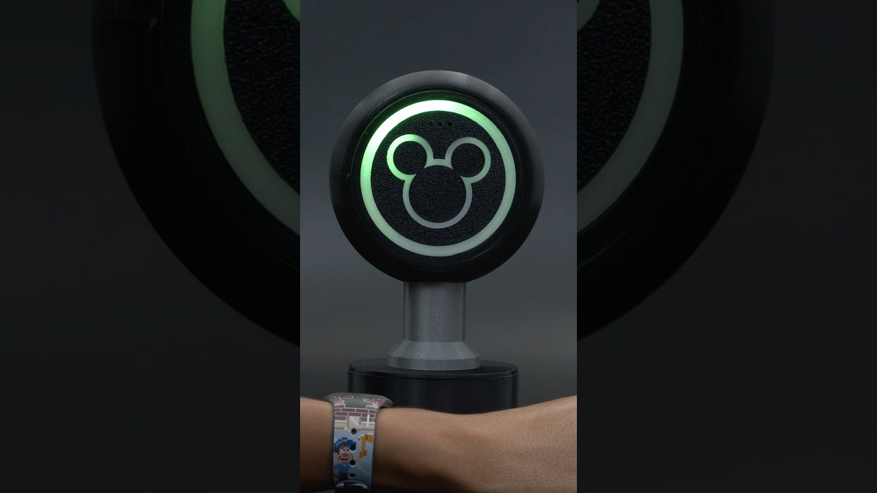

I know that people have made DIY Disney MagicBand readers (you can easily find YouTube video tutorials on that) and that uses DESFire EV1 IIRC, so you could probably make use of the same chip as those projects to make use of the flexDF’s more advanced features.
readers?
Disney THEMED- Generic Arduino RFID reader - would be more accurate
