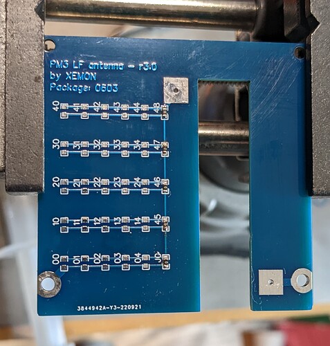

I made a PCB prototype for an LF antenna for my PM3.
The first version (proof of concept) was 3D printed and worked great, so went ahead and got a PCB made (r0)
It did have a small issue and a few things I didn’t like, but it works great.

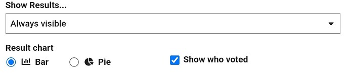

That’s a great idea, looks like I figured out how to make it, but didn’t found the show who voted option.
:partying_face: Thanks
It may also be worthwhile to order some coils pre-wound from a company like this. You can reach out with specs for your antenna and since it’s large they’ll let you get a lower order quantity at a higher per-unit cost. In the end though it will be more economical for you, if you can get interest from 20-30 people. Might be worth reaching out on the Iceman discord to see if there’s any interest there.
If you want any help with antenna characterizing or PCB design to make it spiffy feel free to reach out.

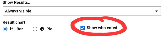

You cant change the poll after 5 mins of publishing, so itf you want to change it, you’ll need to delete and start again, I just checked and there is only 1 vote at the moment.
You could copy the poll “script” and change the the bit where it says “show who voted” from “no” to “yes”
Then paste the new poll and delete the old :man_shrugging:
Ok, thanks everyone for the help and feedback.
I got the who voted figured out so you may have to vote again :sweat_smile:

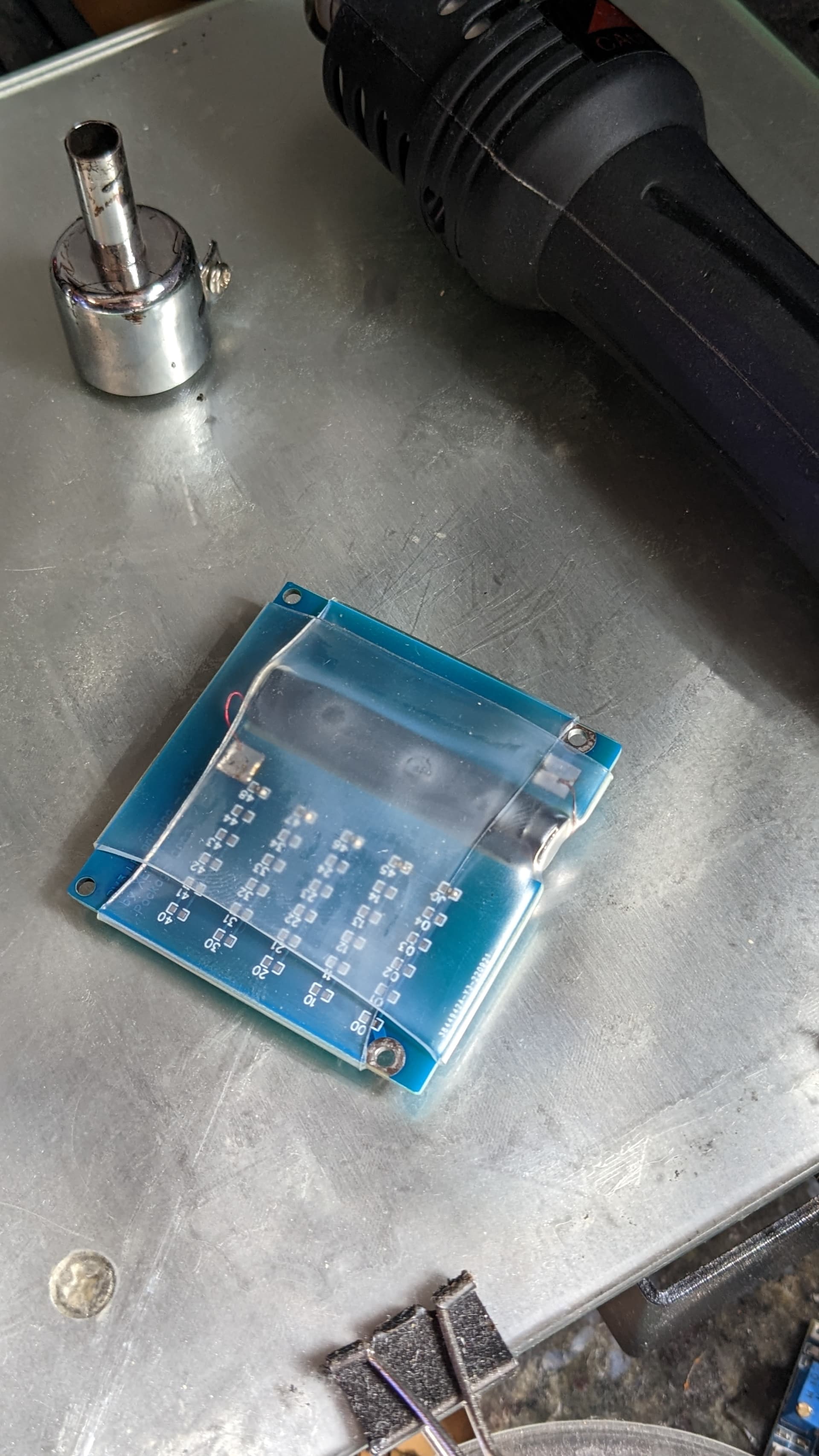

Major update, got the PCB!
Put one together, I haven’t done SMC soldering in a bit and it shows :sweat_smile:

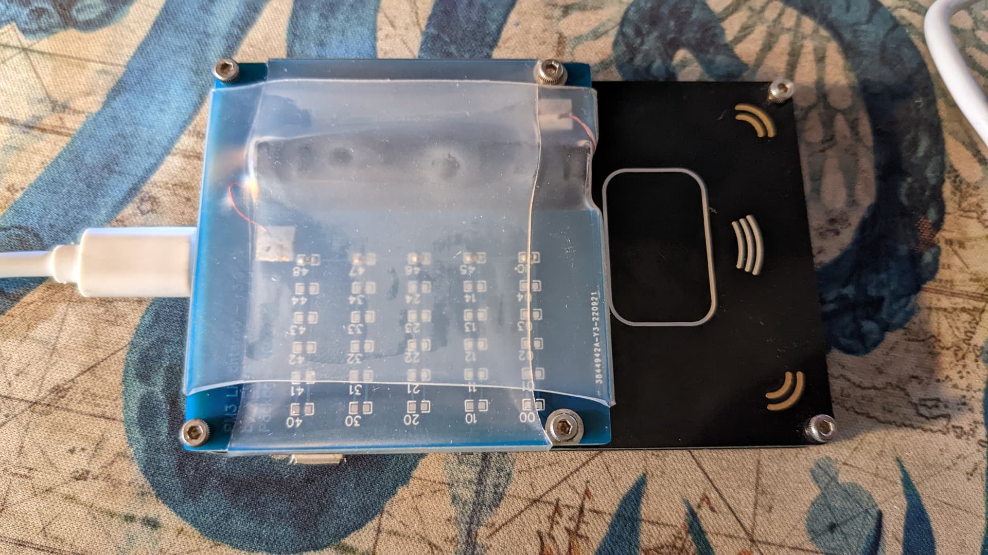

And put the antenna I had on my prototype, wrapped it in heat shrink.
And it works :grin:
Ok, I have a bit of time to put into this again :sweat_smile:
I’ve used the antenna quite a bit and it pairs perfectly every time :+1:

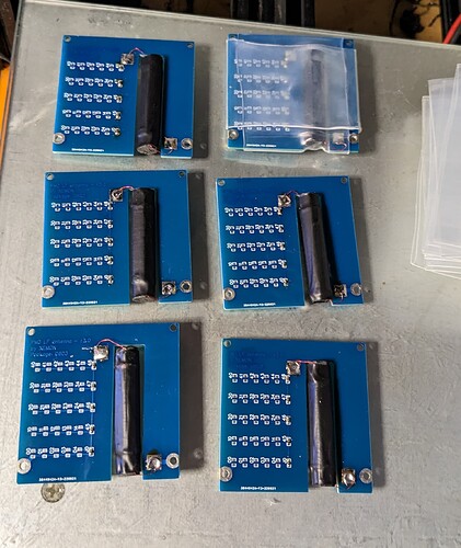

Ok, I got 10 boards ready, I want to ket a few for drop in, the rest is gonna be diy kit right now.
I’ll make the count tomorrow and make a thread for them :+1:

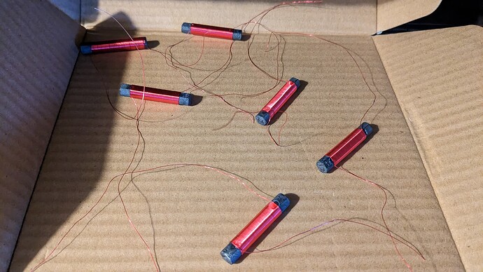

Got the antenna testing board setup, and have 6 cores on hand :partying_face:

What would assembly of the cores likely end up entailing? So folks can figure out if it’s in their skillset?
You make a good point :blush:
Assembling the core takes a few steps.
  1. wrap the wire around the core
  2. test the resistance and inductance of the antenna
  3. adjust if needed
  4. compute the extra resistance needed (if any) and solder it on the board
  5. test the antenna on the proximal
  6. adjust if needed
Repeat 5 and 6 until it’s where we want it :+1:
When I find the time, I’ll make a few antennas, I’ll make a small writeup about how to do it.
Got 6 antenna going, and working on the “DIY kit”.
The kit will include everything you need:
  • PCB with soldered r0
  • ferrite core
  • plenty of wires to wind it a few times
  • all the heat shrink needed to make it hold together nice and pretty :grin:
