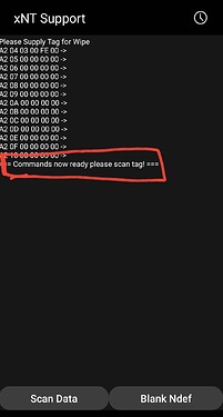

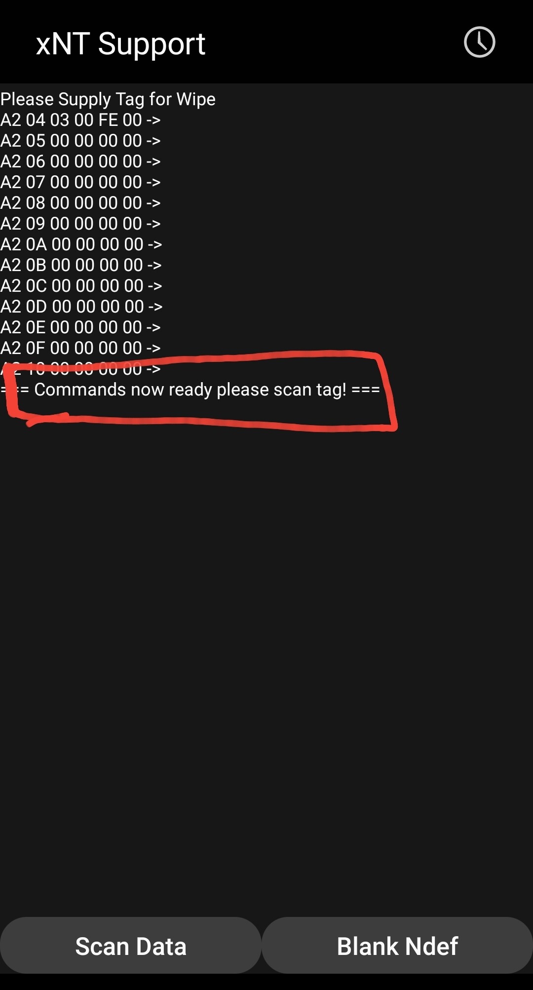

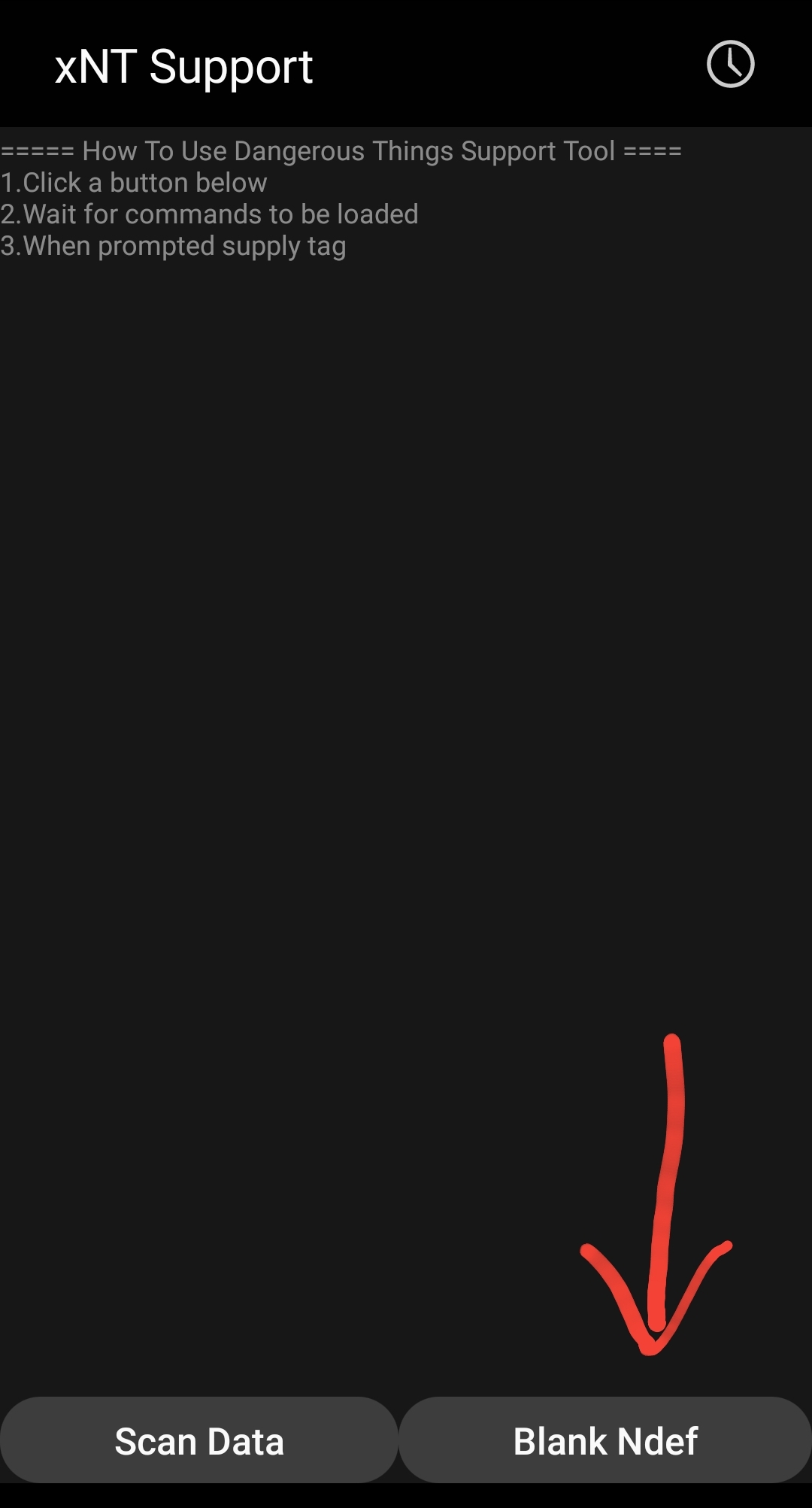

Before that, have you tried
Dangerous Things Support Tool then try to write a blank NDEF record. Once you have done that, try writing a new record.

I don’t have proxmark3 or any other reader writer yet. I just use my phone, but I just downloaded the dangerous things support tool, I will give that a try. Yo thanks for all your help! I love the tech but know zero about coding and how it works so I appreciate the help.
