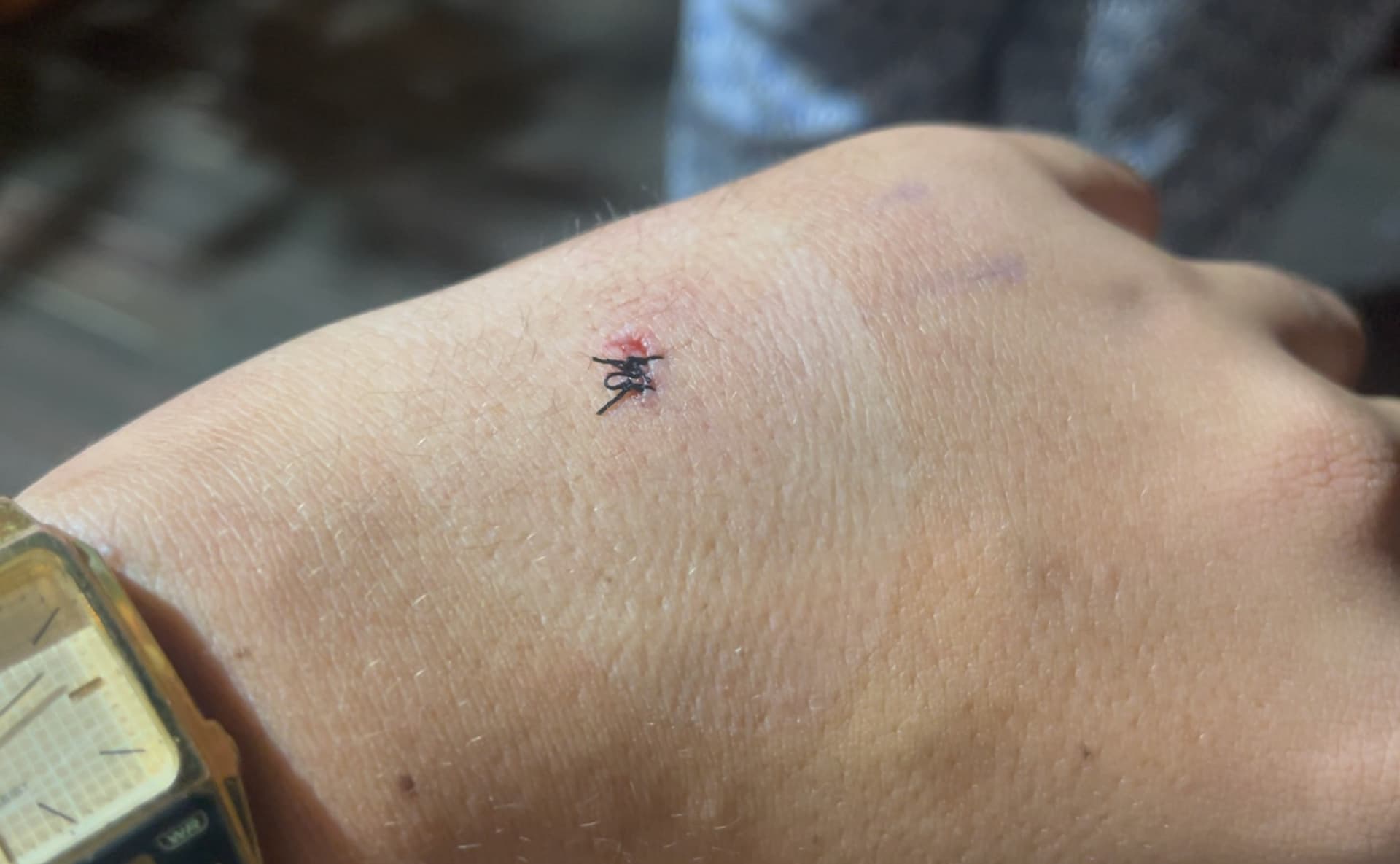

Hey everyone! I’ve got some excellent news!
I’ve done it! I’m so thrilled!
The closest professional installer was Berta from Sacrum Studio in Barcelona, Spain (about a 5-hour drive). She’s fantastic, speaks English, and I can’t recommend her highly enough.
Everything went smoothly. She used a very effective anesthetic that took only minutes to numb the entire area.
I want to thank everyone for helping me on this journey. Especially @Pilgrimsmaster, @LabRat, and @Aoxhwjfoavdlhsvfpzha - your advice was invaluable.
And the range of the FlexNT is incredible!
Here are a few pictures of how it went.
